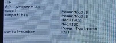

Bawww. I tried. This is after spoofing machine and CPU properties, attempting boot from USB - seems it simply didn't like the file.
did you do a .properties check after spoofing the CPU PVR to make sure the changes had indeed gone through?
the checksum error is normal, but I note your trying that on an AlBook, so I think its hanging up on the GPU side of things, most later apple portables and AIO's dont have the GPU's NDRV in ROM, instead Mac OS X fetches it from disk instead, and the MacOS 8.6 ROM does not seem to like the lack of an NDRV
at least thats my leading theory with it, based on the messing about I have done :)
Yup - not my first time around the block :p both PVR and compatible took the edits to nvramrc
Quite possibly. I've been wondering if editing BOOT-SCRIPT to remove the DO-QUIESCE would lead to more useful debugging info. Never really tinkered that far.
