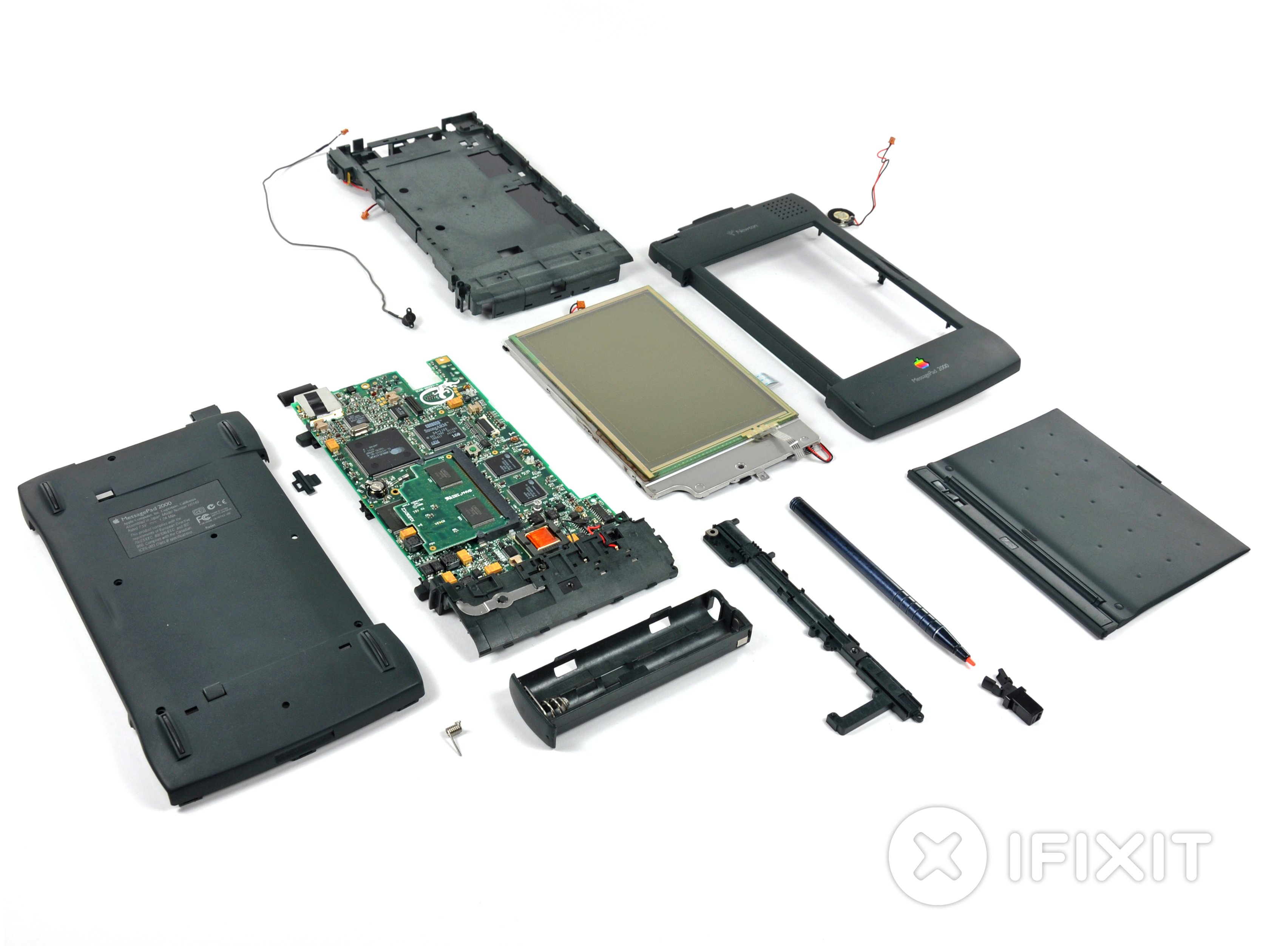

However, I did find another MP2x00 disassembly walkthrough on the iFixIt site.
TonyJay
It’s a single unit, AFAIK.
Not to my knowledge.
Those images are so much clearer! Thank you. The removal of the digitizer ribbon is clearly risky, as even touching the contacts could ruin the functionality. Will need to study this in detail before I try ECL replacement. The good news may be that I can get to display cable easily to see if it has been damaged, or reseat it and see if that will fix the missing 1/2 of the screen. Still has not arrived yet... mail from US to Canada is always a lot slower due to customs. Thanks again! So helpful.
