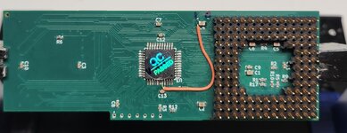

Unrelated to both topics, the ROM booster/acceleration functionality seems stable and being field tested now. It appears to provide a minor but still relevant performance gain. All existing booster 2.0 cards can support this functionality, if you're interested in having the upgrade applied just send me a PM. Due to the lack of an easy way to configure it, the best option I've got is to add a bodge wire that would need to be desoldered in order to switch the enabled state.

Any recent production PDS cards now have a DIP switch on the rear of the card. Socketed ones have it on the bottom next to the PGA pins. So enabling and disabling ROM Boost is easy now.
