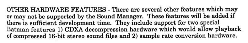

Is this of interest to this thread?
I think it is! CDXA decompression hardware would be exactly what's being used to decompress the startup sound and alternate startup sound in the Q700. So...what that tells us is early in the project they weren't sure if the EASC was even going to have this decompression support. But clearly they were able to pull it off. It's funny though -- as far as I can tell the OS never got support for it. So did it actually ever do anything for them aside from letting them compress the startup sound and squeeze in a second alternate one? :)
Bet they implemented it in the "bong" to confirm it worked during hardware bring-up... Then never actually got time to add it to the OS. Shame - hardware audio decompression would have been good for reducing CPU in games perhaps?
