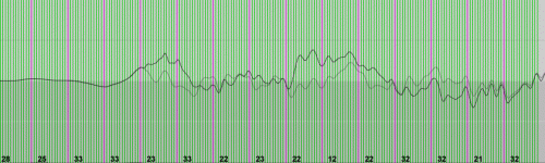

Most of the remaining issues come from where one packet hands off to the next, even if the packet type remains the same from one to the next.
I think that you have to partially calculate the next state in the current state.
Dennis Nedry
I've cleaned up the code and it actually ended up making an extremely slight improvement to the sound. But the code is simpler now.
In the image the I posted that shows each packet with magenta lines - it looks pretty much like those magenta lines are supposed to move two spaces to the left. I'm not sure why. Maybe the sound program I'm using snips off the first 2 samples.
My latest theory is that type 3 should not use a table - somehow it should take a similar approach to the other waves where they are actually calculated out.

Dennis Nedry
Actually it improved it more than I thought! I keep track of the "delta" variable better when switching between packet types now. I still don't know what the HECK is going on in the 5th packet though.

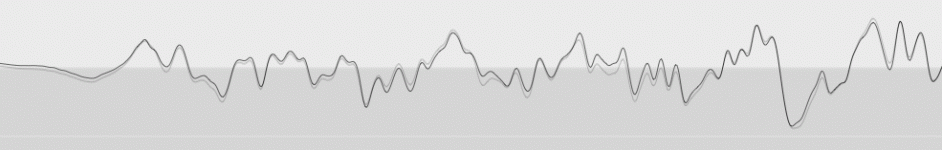

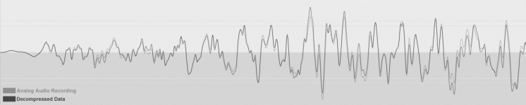

Well, if I was a good engineer, I would know when to stop. :p But hey, this isn't work, it's for fun, so too bad. ;)
https://sites.google.com/site/benboldt/files/Q700DataOut7.aif
I can no longer hear any problems in the sound with my ears.
Some of the differences are probably because this is an analog recording with a high-pass, but there are clearly some spots that are logical issues.
The big change that I made was that I calculate the sinc wave directly using deltas now instead of scaling a cosine table. There are no longer any tables in the converter at all.
I'm betting that the remaining issues have to do with using previous/next state of variables, i.e. updating them before or after using them to modify the output. Maybe rounding could be an issue too, who knows.
I can't believe how concise the code has gotten! That's a really good sign for its accuracy.

jongleur
Excellent analysis and coding. Really appreciate the montage you just posted showing the evolution of the sound work.
Three Cheers!!
dougg3
All of the scratches are gone...woohoo! I agree--that montage is great!

Here are the 3 wave types graphed in Excel - this is where I experimented to find the right values. All three are given the same first nibble, then the rest of the nibbles are all 0. So this is basically a unit step response for all 3 wave types.
Maybe the blue wave (type 1) starts 1 sample too soon?
Dennis Nedry
In the type 3 mode step response, general shape and initial phase look great but:
- Amplitude is a tiny bit too high
- Frequency is notably too low
I'll see what I can do about tweaking that a little bit.
The small oscillations on the decoded version (black line) are from interpolation to get to 88.2 kHz in Sound Studio. They do not exist in the actual 22.05 kHz data. The large square step on the left side is from a maximum type 0 packet for normalization purposes.
Dennis Nedry
In type 3, I was updating delta with this:
delta += (envelope / 3);
And the correct calculation is:
delta += (envelope * 3) / 8;
This produces a perfect result for type 3 as far as I can tell. I will apply this same method to types 1 and 2 now.
Dennis Nedry
I actually believe that it's perfect now. I can no longer see any differences that aren't caused by the analog connection. Both waves follow the exact same shape now. In this picture, the lighter line is an analog audio recording. Scrolling ahead and looking at lots of areas of the sound wave, I have found nothing that indicates a problem with the decompressor.
