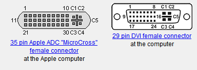

I was wanting to run dual displays on my PowerMac G4, but unwilling to spend £30 on the adapter to turn the ADC port into something more useful. This cludgy mess is what I came up with :) - it does work though! I used the connector from an EVC cable which I got on eBay for £2.50, but removed the original shroud from the plug so it would fit in the socket.

I did write down the diagram which I used to make the cable -
