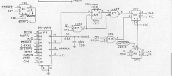

If I'm reading this correctly, the logic prom is sending a signal to D5 -> E7 -> A11 -> PH0 which is the input on the 6502
Starting from the F7 pin 13 PROM:
This carries exactly to E7 pin 8.
Then the moment it reaches A11 pin 2 it turns into this garbage.
This carries out of pin 5 directly into PH0, input on the 6502. Which sees exactly what's coming in on pins 2.
Possibilities of A11 being bad? One of the only IC not socketed unfortunately.
Or something along the path?
Interested to hear any ideas on that one, along with getting CPU fixed before video? Or try to bum rush getting video fixed?
If it’s good at the output of E7 and bad at A11, it’s more than likely a disconnect in the signal somewhere along the way. If E7 is socketed, then the pin of E7 might not be making contact with E7’s socket. I’d measure E7.8 at both the IC pin and at the socket pin where the socket is soldered to the board.
If it’s good at the socket pin, then it could be a broken trace or solder issue somewhere between E7 and A11. If A7 were bad and it was dragging down the signal you’d see the same thing at E7.8 - which is why it’s more likely that there’s a disconnect somewhere along the line.

So I'm looking at this diagram yet again. Timing seems to be a pain!
I decided to go even further back. F7, pin 5, C1m, has to come from somewhere.
It leaves B12 on pins 10 and 11 perfectly at 1.19mhz.
I know it leaves B12, because D11 in this diagram sees 1.19mhz come in on pin 2 -> leave pin 5 or vice versa, in pin 5 out pin 2. (it's right above it, cut off in the screenshot)
So I checked the bottom of the board where pin 5 is for F7. 1.19mhz, yay! So that works.
Checks leg..dead as a doornail. Nothing coming in.
Cleaned the socket and chip again and finally a 1.19mhz singal is there.
Pin 13 now sending 1.19 -> D5 12 -> D5 9 empty. Swapped D5 and D11, still nothing on D5 pin 9.
D05 is a 74S74
Could it be something with E7 stopping the flow to pin 9?
E7 is looking for Q0 and RAS. Q0 comes from D10 pin 15 carrying a 1.79mhz.
E7 pin 12 just sees flatline unfortunately.
RAS comes from B12 pin 14 and looks like a nightmare.. don't know what it's supposed to really see.

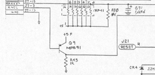

New on the list of things that just screwed up.
A resistor that blew out.
Put G12 back in, turn on to look at something.
Hear a pop/crack and a burning smell. Turn it off and look by smell and bam, a resistor that went boom.
That'll be getting replaced.. in the meantime. Anyway to know what could've caused it? It's R43. I can try and find it in one of the schematic pages but might not be able to directly understand why.
I tried to trace it on the board but god those traces are tiny and go under IC and such
Not going to turn it back on till I get another resistor and new IC at least though.
Unless it's safe to, but I assume not since those usually blowing is definitely not a good sign
joshc
Some of those traces look scabby (see the black marks along the traces), do they have continuity?
Some of the solder joints look pretty scabby too, can you try to clean them up a bit more?
pball52998
Well, in an unexpected place.
Keyboard logic!
https://apple3.org/Documents/Schematics/Keyboard Logic.jpg
APPLE /// LOGIC SIGNAL SOURCE
Signal Location Meaning
KVCC 9-4b KEYBOARD VCC
From the manual
Keyboard Light: The keyboard light indicates the VCC is provided to the keyboard. If no light is observed, check Q9 [MPV 511]
So the power to the keyboard (not plugged in) caused the resistor to blow from the transistor?
I don't even have the keyboard IC plugged in since it basically turned to ash (rusted entirely and over 12 legs fell off just taking it out), nor the cable for the keyboard.
Don't think the connector to the keyboard needs to be plugged in to test.. but I may be wrong!
