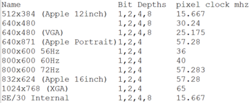

Complete resolutions supported:

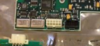

I don't believe it would be possible to upgrade a Rev D card to 30HR. It seems that card used discrete crystals rather than the clock generator chip introduced on Rev E that has many discrete frequencies documented in the tech docs. Recognize by looking for this: 1685723941273.png

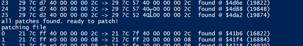

Patch technical details...
The ROM patches needed are as follows, along with the offsets into 369C.ROM
Two changes are being made:
MOVE.L to offset 2C (kMavAModesA) against register A0 or A4, invert the MSB for the G300EN bit which polarity changed in the Gambler chip.
MOVE.L to offset 08 (kMavBModesB) against register A0, clear bits 22 and 23 to set DEBUGSEL to 0 (TRANSWAITB)
0 21 7C ff 40 00 00 00 2C -> 21 7C 7f 40 00 00 00 2C found @ $41b6 (16822) 1 21 7C ff e0 00 00 00 08 -> 21 7C ff 20 00 00 00 08 found @ $41f4 (16884) 2 21 7C fe e0 00 00 00 08 -> 21 7C fe 20 00 00 00 08 found @ $4218 (16920) 3 21 7C ff 40 00 00 00 2C -> 21 7C 7f 40 00 00 00 2C found @ $43f2 (17394) 4 21 7C ff e0 00 00 00 08 -> 21 7C ff 20 00 00 00 08 found @ $4430 (17456) 5 21 7C ff 40 00 00 00 2C -> 21 7C 7f 40 00 00 00 2C found @ $44b6 (17590) 6 21 7C ff e0 00 00 00 08 -> 21 7C ff 20 00 00 00 08 found @ $44f4 (17652) 7 21 7C d6 60 00 00 00 2C -> 21 7C 56 60 00 00 00 2C found @ $457e (17790) 8 21 7C ff e0 00 00 00 08 -> 21 7C ff 20 00 00 00 08 found @ $45bc (17852) 9 21 7C ff 40 00 00 00 2C -> 21 7C 7f 40 00 00 00 2C found @ $4646 (17990) 10 21 7C ff e0 00 00 00 08 -> 21 7C ff 20 00 00 00 08 found @ $4684 (18052) 11 21 7C d6 60 00 00 00 2C -> 21 7C 56 60 00 00 00 2C found @ $470e (18190) 12 21 7C ff e0 00 00 00 08 -> 21 7C ff 20 00 00 00 08 found @ $474c (18252) 13 21 7C d6 60 00 00 00 2C -> 21 7C 56 60 00 00 00 2C found @ $47d6 (18390) 14 21 7C ff e0 00 00 00 08 -> 21 7C ff 20 00 00 00 08 found @ $4814 (18452) 15 21 7C d6 60 00 00 00 2C -> 21 7C 56 60 00 00 00 2C found @ $489e (18590) 16 21 7C ff e0 00 00 00 08 -> 21 7C ff 20 00 00 00 08 found @ $48dc (18652) 17 21 7C d6 60 00 00 00 2C -> 21 7C 56 60 00 00 00 2C found @ $4966 (18790) 18 21 7C ff e0 00 00 00 08 -> 21 7C ff 20 00 00 00 08 found @ $49a4 (18852) 19 21 7C d6 60 00 00 00 2C -> 21 7C 56 60 00 00 00 2C found @ $4a2e (18990) 20 21 7C ff e0 00 00 00 08 -> 21 7C ff 20 00 00 00 08 found @ $4a6c (19052) 21 21 7C fa 40 00 00 00 2C -> 21 7C 7a 40 00 00 00 2C found @ $4b82 (19330) 22 21 7C df e0 00 00 00 08 -> 21 7C df 20 00 00 00 08 found @ $4bc0 (19392) 23 29 7C d7 40 00 00 00 2C -> 29 7C 57 40 00 00 00 2C found @ $4d6e (19822) 24 29 7C d7 40 00 00 00 2C -> 29 7C 57 40 00 00 00 2C found @ $4d88 (19848) 25 29 7C d2 40 00 00 00 2C -> 29 7C 52 40 00 00 00 2C found @ $4da2 (19874)
