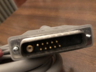

Love those things! If you want an official cable, this one looks correct to me, though depending on where in the world you are the shipping might be too much. Ends fairly soon, though!
(The Portrait Display only needs the one coax connector)
Ah I think the RasterOps cable I got works (FYI for anyone in the future trying to determine if a RasterOps DA15 <> 13W3 cable works with Portrait Display), as the main issue with 13w3 is just making sure you're not getting the Sun version which is wired differently. This cable also included a Griffin Mac Sync adapter, and the picture is coming through so I strongly suspect it's Mac-specific. Took a gamble on this one, was about $60 cheaper than the real thing!

Welp spent all evening on it, couldn’t figure it out. I guess didn’t have the right combo of software/drivers to get it to work, so I’m going to sell it locally in SF Bay Area.
FYI: Sun also used a 13W3 cable that was not pin compatible with Apple's 13W3. So even with an switch adapter, it won't work.

I picked up @nickpunt's monitor today and confirmed the same results as he saw. Connected it to an 8*24 card which is known to support the portrait display and still I'm unable to get proper sync. A standard cable for the portrait display doesn't require an adapter. But the fact that this particular RasterOps cable requires the griffin adapter (it's a DB15 to DB15 adapter) means it's still possible it's the cable that's the issue. If not, something's gone bad with the display. Will have to debug this when I get some time.
