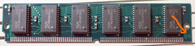

Fortunately, this card comes with the extra RAM SIMM to provide 8-bit color. Since the memory was an expensive original option (it cost more than the card itself), and it is an unusual 84-pin SIMM, be careful to check if the memory is included if you have an opportunity to purchase a card second-hand.

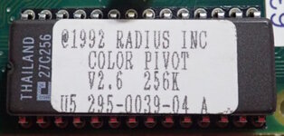

The ROM is version 2.6. Let me know if you need a copy. I will upload it when I next hook up my EPROM reader.

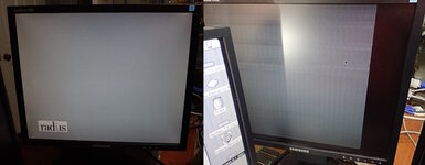

You do not need a Radius Pivot monitor. LCDs display the 640x480 crisply (left image below). However, I couldn't find a monitor that supported 640x870. It keeps trying to display 1280x870 (right image below) poorly.

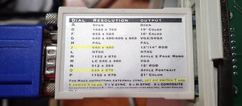

If for some reason you see the Radius logo on the screen after boot, go to the Monitors control panel. On cold install or PRAM clear, it just needs to have the video mode selected by the user to hide the logo. However, if the display doesn't show up in the Monitors control panel at all (even if displaying the logo), it could be because of the VGA adapter. I noticed it was a little finicky and needed exactly the right dip switches for the card to recognize a connected display. I swapped to my "Liberty" brand adapter and it works fine.

How can I change the resolution on this card? It‘s always in portrait mode. I don‘t have a pivot monitor. I tested different versions of the Radius Software and inside a 475 and a Color Classic with no differences…
I assume you have a video adapter connected on the output port? It should have DIP or rotary switch settings to choose the resolution.
I tried a Macintosh Color Display (M1212) and it couldn‘t display the image. The other display I used is a 19“ LCD screen using a fixed Mac to VGA cable which can sync somehow, but vertically shrinks the image. Both screen work normally using built-in video. I have never seen any option to rotate to landscape or set a different resolution from Software. I can try using an adapter with switches, but don‘t know which settings to set…
