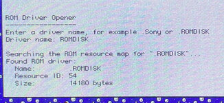

As for the ROMDISK itself, looks like it is there just not opened. Give this a try. When the console comes up, type in ROMDISK. Then check Tattletech again to see the status. Hopefully this mounts the ROM disk in the Finder. If not try Rob Brown's dumpdrives. You can enter the drive number in there and post a disk event as well.
After typing ROMDISK and pressing enter, I see the following flash up for a split second, then I crash with an illegal instruction.
OK, I must have something terribly wrong in that driver. I'll port this over to like a Quadra so I can do some on the fly troubleshooting. More to come!
