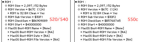

Here's how Tattletech reports the ROM before and after the upgrade. The sub-version changes from $30F1 to $30F2, so it's essentially Rev A. vs Rev B.
A couple of declaration ROMs are updated.

I don't think it's anything cynical. To clarify, you can run a 550c CPU in an earlier model, but not the other way round. The 550c/30F2 ROM has a special driver to run the larger display.

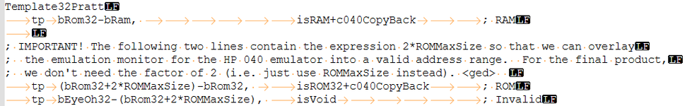

I also took a look at the MMU tables for the Pratt memory controller in the 550c ROM. Here are the offsets. Seems to look like it is already setup to utilize the full 4MB.
Also the MMUTables.a code seems to also indicate that 2*ROM size is being allocated.
So the full range 0x40000000 to 0x403FFFFF might already be addressable. I could probably mock together a 4MB ROM file for you that has an embedded ROM disk driver in the first 2MB, and the ROM disk in the second 2MB. I won't really have a way to test it, but you could try burning it on your prototype whenever you get around to it. Want to give this a try?
