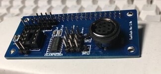

However, I do have some GOOD news for a change! I finally got a chance to do some soldering and have the first one assembled and cleaned. It's at the moment untested, but I hope to get to that soon. I gotta drag a 68K machine out of the corner and set it up on the dining room table again along with an o-scope to check that everything is OK.

Finally got a few minutes for myself, and... my PicKit 2 won't talk to MPLAB. So, I've ordered a new PicKit 3 off of Amazon; should be here sometime wednesday.
PicKit3 arrived, and is now successfully talking to MPLAB; and has programmed the first PIC12F1840. The first hat should be done; I'm planning on testing it tomorrow (er, later today - it's 4AM, and I really need to get some sleep).
Got a few more spare minutes tonight...
Well, the good news is that the magic blue smoke is still in the epoxy IC packages... I still need to dig out my oscilloscope to see if the signals on the board are behaving, though... also need to setup a machine in here that has a LocalTalk port. Tashtalkd is installed and appears to run, but I don't have any traffic flowing through it yet.
Eh... not really "bad news", more like "odd news"... but for some reason the "lite" version of Raspberry Pi OS won't talk to my WiFi network. Spent a few hours fighting that before giving up and installing the full 3GB version onto the SD card... which, inexplicably, works just fine.
