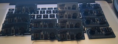

I ran into a soldering issue on a couple of boards... that means that counting one for micheledipaola, the entire batch is now spoken for.
All the boards have been assembled; but they haven't yet been cleaned of flux residue or tested. It's possible that a board might fail testing and require a bodge wire, but I'm hopeful that won't be the case. If so, I'll include some more boards & parts on my next order with JLC/DIgikey/Mouser et all, and send out a non-bodged board to any unlucky recipients of the ones that failed testing.
Hmm... looks like the minimum size box that the international post will accept is larger than the boxes I have on hand... and the local office supply stores are all showing either excessively oversize boxes, or (ironically) mail order only. So, off to Amazon I go to get a bigger outer box so the postal sorting machines are happy.
As soon as that gets here, I can weigh the entire package and get shipping quotes for everybody.
And yes, the eagle-eyed among you may notice that two of those still need female headers attached (aperezbios had asked for unsoldered headers, which accounts for the other two).
All boards that have headers pre-soldered have passed testing OK - no bodge wires required. Obviously, I haven't been able to test aperezbios's two, because the headers are, well, unsoldered. ;)
