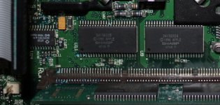

yes, it does have two on board roms:
These two guys are what the 6500 uses to boot so I'm thinking it might work without that rom simm...
There is no ROM SIMM for the TAM, never was unless proto.
Good theory on the ROM with startup chime. I can not say, but falen5 I think has the skills to swap ROM chips if needed.
It's not a rom simm , it should be cache card, which with a G3 upgrade should be removed. Maybe that's why it was put away and didn't work in the first place.
Rom simm and cache cards use the same slot on those boards. In fact my 6500 says rom/cache slot.

as for the rom's etc etc ....heres a few snaps of the board.
Ive never had a tam before so I make no claims. But the board says rom , cache, and drams - I don't know!
anyway will try to put it together and see what happens. If it powers up ill try it with and without the rom.....just to see if there is a difference.

The part number shows its a G3 ROM? I wonder if someone thought it was or is needed for the upgrade card? I never heard of that if so. And like I said, the TAM never shipped with its own ROM card.
And the plot thickens... The funny thing is that the 6500 board has the pads for the rom but not the socket?
Ya, the 5500 & 6500 are the same board as the TAM, just with modifications. My guess for the TAM having the ROM slot installed is given the unique nature of the machine. Its pretty common for Macs, even the PowerPCs, to have a ROM slot but no ROM intended for it. Being what the TAM was, it may have been a safety net thing.
Nearly all of my TAM's which is a gaggle at this point, came with the chip but I don't have them in. They work without any issues. Given the corrosion, I wouldn't install it as it could cause more issues than doing anything positive.
