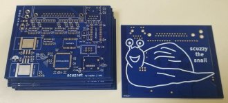

The PCBs are finally out for delivery today via DHL. I'll keep y'all updated.
Let me guess... delayed by Chinese New Year and Coronavirus? I did a run of PCB's for a conference badge a few weeks ago, and at the last minute I had to do an emergency order from a Korean PCB manufacturer because my order from JLCPCB so delayed. It sounds like a lot of people have been affected by this.
Looking forward to seeing how they turn out!
That’s surprising, since I recently got an order from JLCPCB and they told me they weren’t experiencing any interruptions due to Coronavirus.
