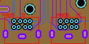

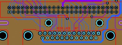

For all testers of this initial batch - i forgot the GND and +5v connections for the disk and serial - DOH! For some reason i skipped over them, it's fixed in the latest Gerbers, but the prototype batch will need these connecting - nothing major, just solder bodge wires and bridge pins for the SCSI - should see from these images where the GND and +5 connections are - light brown is +5v, dark brown is GND.
