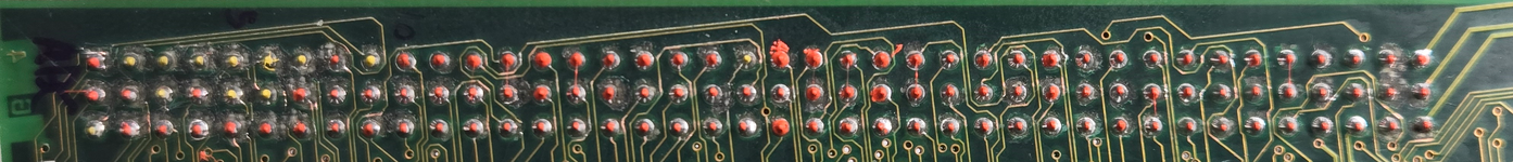

Destroyed traces near the desoldered connector is exactly what happened. Two bodges later - D8, and IPL2 - it boots! And the cache even works, great!
Now the next steps are to clean up, reinstall the PDS connector, and bodge that to life. So let's get to it. The card stops booting after the connector is reinstalled.... because loose trace ends have gotten soldered to other pins. Oops. I have to go clean all those off while consulting pictures of an undamaged card. OK, great: works, again. Let's tone out and see what pins are bad up top.

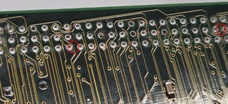

Yikes. Orange is good, yellow bad. (I grabbed the first two paint pens I had, sue me)
This is where things go awry. There's been no electrical changes since getting the PDS connector reinstalled and the bad hanging traces removed. Just some inspection and toning. It should still work, but it crashes when the cache is enabled. Ughhhhh. OK, well, I clearly messed something up, let's remove things one at a time and eliminate variables.
In order of desperation, this is what I did, all without a change in behavior. Instant lock when cache turns on.
