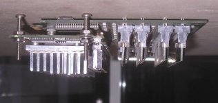

I was thinking about the 9150 riser and tightening up its slot spacing like so:
If limited by headroom, such would require flipping the orientation of the slots back to front. But there would be plenty of room on the riser for that, far more than the Cache Slot shenanigans required for the PowerCache adapter @Bolle came up with for the SE/30.
Per your pic and my playtime:
Something has to give to make it work.***** In these more conservation correct times, mayhaps a bit more civilized approach is required? A split level, two slot riser seems a fairly civilized approach and just just fit without slotted case bottom or bob-topped card.  It would still require a bit of internal plastic member removal, but nothing drastic. Making a cutout in the PSU shelf about an inch deep enough along the dotted lines and application of electrical tape to the bottom of the PSU.
Even the placement pins of the slot part would fit, better holding the soldertails on the riser away from the electrical tape above.
Split Level Riser:

Mechanical type drawing: can't work, the ports on the back and the logic board mounting screw pylon interfere with that craziest of notion, but it was so good  for me to play with the tiny, portable, clipboard drafting table/tool set again.
ASCII art version: too complex and to much plastic removal. finding the right offset for the split level boards would be a nightmare, if it would fit/install all, but that got me back to cables again.  :rolleyes:
So, as I started packing the piles of junk away, looked at that cable notion for the split level contraption and accidentally noodle out a way to install everything in a non-destructive way. But for possible (almost certain) breakage of that dang brittle-ized plastic swingaway contraption in removal/re-installation the hack is ever so possibly reversible  ,  ,  ,   if using a heat gun to soften the blasted thing for removal might do the trick.
One custom riser PCB, two PCI female connectors, headers/IDC connectors and a pair of off those ordered on eBay cable based PCI risers required. The project is go again.
Dropping this assembly to the level of the shelf so the low side of the riser board all but clears the top of the 8500's bottom PCI slot backplane rplate even with the too wide PCI riser's edge card connector intact, it's still hung up on the protrusion of the drive support shelf into the card cage cubic.
Bits and pieces: as said, the cable thing's off the shelf PCI stuff. The slot part of the riser is lopped off along the blue line right from the start. One end of each edge card assembly is hacked away, reducing one end to the length of the wide side of the PDS, a PCI Slot. The wide part of the second cable is trimmed to match the narrow end of the PDS closer to the backplane. Dunno what that slot connector is called, but it's probably a standard part or should have been, but you know Apple.
I won't get into the option of using headers and IDC junk to avoid soldering the cable's wires directly to the board. It saves only about 3mm of the risers' edge card contacts if done that way. We'll go straight on to the more secure, less electrically hostile approach.
Given: lopping off the socket end, stripping and soldering all those cable wires straight into the custom adapter PCB is more tedious than soldering headers into the PCB and crimping the matching connectors onto cables. However, soldering wiring straight into the new adapter card saves a full 7mm, removing the edge card teeth all the way back to the red line and reducing the slant of the HPV card considerably.
