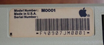

After several unsuccessful purchases, I've obtained an original unaltered Macintosh 128K. Model M0001 serial number F40907JM0001 (the 256th Mac manufactured during the 9th week of 1984 in Fremont, California, USA.)

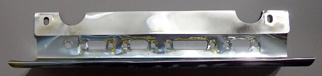

I believe @JDW removed the metal shield from his Mac, out of concern that it interferes with airflow. Apple removed it from subsequent analog boards, so it is either unnecessary or a hindrance. Since I do not intend to run this Mac, I will leave the metal shield intact.

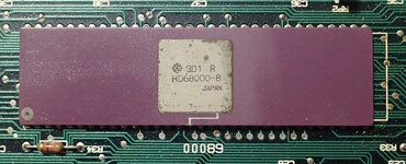

It's nice to have a purple ceramic package. This is the Hitachi HD68000, which would be an alternative supplier to Motorola

Speaking of @JDW, this Mac's analog board contains...
the aluminum RFI shield that ran along the top edge of the board

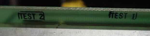

There are a few inspection and test stamps on the analog board.
