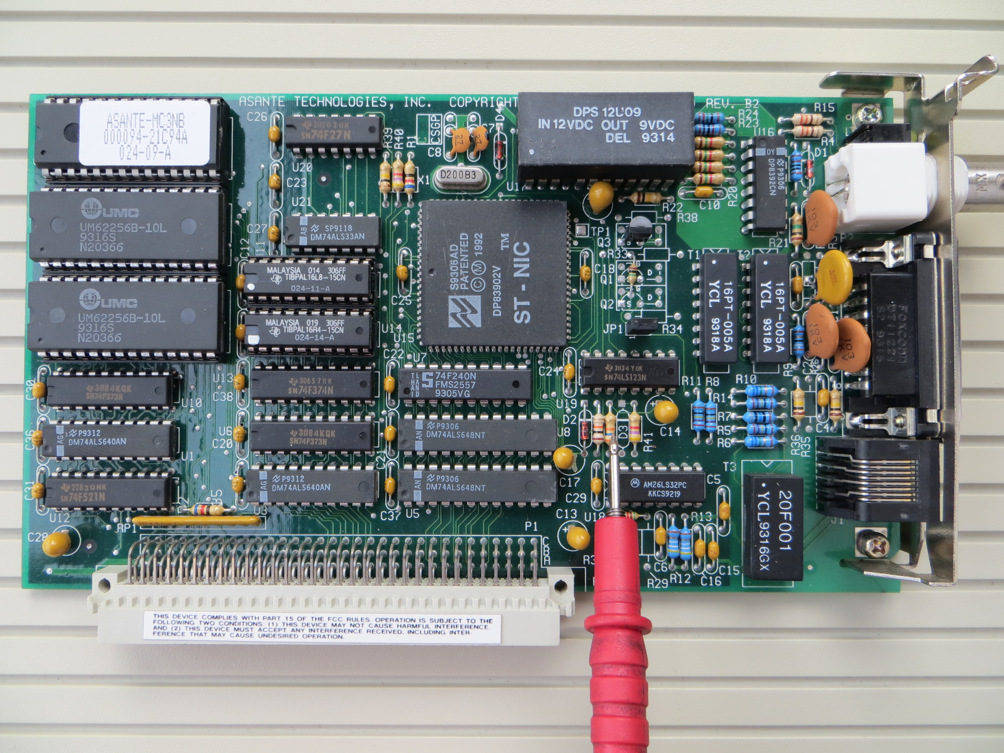

An Asanté MCLC LC PDS (with FPU socket; I added an FPU) (c)1993 will not form a link on an auto port. It will link on any fixed 10M port, full or half duplex. The card is in perfect condition. There is a socketed chip, likely a ROM (can't tell because I don't want to destroy the paper label that covers the stamping), so perhaps there is a ROM update for it. The buffer RAM is 256Kb=32KB and there are four extra pads; I wonder if it can be expanded to a 64KB buffer? There's a jumper as well, J2; it may be for link integrity.
A DaynaPORT E/LC SE PDS (with pads for an unstuffed FPU) will form a link on an auto port on the GS308E. It is built around the NS SONIC chip. I'd put a socket on the FPU pads, but this is used in an LC475 with an FPU'd '040, and so the empty pads are best.
The NuBus NIC is an Asanté MCNB Revision A. It is built around the NS ST-NIC and I expect it will form a link on an auto port. It is rather similar to the SE PDS, similar enough that I think the SE PDS jumper is to en/disable link integrity checking; the NuBus has a jumper with silkscreen text that explains it. This too has a 256Kb buffer RAM with extra pads and this one I might try to replace with a larger RAM, but there's no guarantee the ROM detects the RAM size dynamically. This is intended for a IIcx that, if I can stabilize it, may become the one old Mac I keep.

One of my IIcx's was in its happy-chime mood today (that one is very sensitive to flexing of the logic board.. re-solder party, soon) and I determined that the Asanté MCNB Revision A will not link with an auto port. It will link 10M full, though, so again - something was gained.
So, nice tip, @Mk.558 - I will review Tinker Different for any tips on modding this revision of the MCNB.
FWIW: the eight-bit wide static RAMs of that era appear to have followed a common pinout. Replacing these 32kilobit RAMs with larger ones is electrically possible, but I have had trouble finding parts. Some of the overseas salvage yards have them in DIP, not SOJ packaging and I could probably just bend the pins.. but.. another day. These work fine without extra buffering.
What does it look like?
If it looks like that, then just replace the resistor marked, to 220K or something around there ohms. 270K could probably work too.
Mine's different. Although the 26LS32 is still there, I think the ST-NIC handles the support provided by outboard logic in the Tinker Different schematics.
