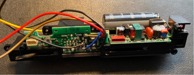

There is just one small cap to replace. For the large 300V cap I couldn’t find a suitable replacement so I had to leave it. I suppose ‘photo-flash’ caps aren’t that popular anymore.
All boards taken out. You’re done – hope you organised all the bits and pieces nicely. Go ahead and recap everything, then follow this guide in reverse order to reassemble.
