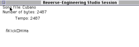

I'm currently not understanding what I'm seeing. After loading a song file, I get its content with:
C:
err = GetEOF(fRefNum, &fileSize);    //get the size of a file opened with SFGet, which gave me a fRefNum\
gHandleFileContent = NewHandle(fileSize); //allocates RAM to the content handle
if(gHandleFileContent == 0) errorCantAllocate();
HLock(gHandleFileContent);
FSRead(fRefNum,&fileSize,*gHandleFileContent);      //put the content into extern global file content buffer
HUnlock(gHandleFileContent);
At this point, if I check the value of fileSize, I get 2487 (0x09B7) for the song 'Cubano', which reflects what I'm seeing in an hex dump of the file (although the last byte is 0x09B6? Is there a reason it's off by 1 byte?)
And now, the weirdest thing. Believe me I've tried every variant I remembered, counter checked with the page on Handles in THINK Reference. I'm trying to get simple data from the header of that song file at specific, known positions. The first 2 bytes contain the tempo information. The useful values recognized by the Studio Session format go from 10 to 450, so you need 2 bytes for this. Cubano has byte 0 at 0x00 and byte 1 as 0x96, for a decimal tempo of 150. When I was using FSRead to pick out this and other basic song data piece by piece using FSRead multiple times, advancing at a pace of 1 or 2 bytes at a time, there was no issue at all. I just want to do it at a later time, arbitrarily often, by reading it off a handle pointing to the read file's content long after the file is closed.

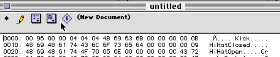

If I dump the first 20 bytes as (10) characters straight up from gHandleFileContent, I get the same thing I see in the file's hex dump (BBEdit):

I just rechecked the fileSize after FSRead is done, no change (still 2487).
I found the error!
The condition that had to be met before I could extract the first 2 bytes to get the tempo was this:
C:
if(GetHandleSize(gHandleFileContent) ==noErr)
The mixup is that I thought noErr was returned by GetHandleSize instead of MemError (which wasn't used here, but maybe should!). By demanding == 0, I was only going to (catastrophically) extract the bytes if and only if the Handle pointed to nothingness, which was confirmed not to happen at this point. My GetFirstTempo function was perfectly happy doing nothing after it failed its check and the compiler was perfectly happy to let it not return any value. A modern compiler would have cried foul and I would have investigated it.

Last bit of problem - I'm not sure I understand every seam of the bitwise operations when it's not done on longs as part of a char to short conversion on top of it.

ptr = *gHandleFileContent; //first byte is 00
result |= *ptr; //result becomes 0x0000, great
result << 8; //result stays 0x0000, great
ptr++; //*ptr is now 0x96, great
result |= *ptr;  //result becomes 0xFF96 ????

Your original code was getting a sign extend on *ptr, since 0x96 has the high bit set. So “result |= *ptr” is getting turned into “result |= a short conversion of the signed value contained in *ptr” which would be 0xff96.
I think if you had declared ptr as “unsigned char *” you might have gotten the desired result from your original code. But yes I personally would also have done something more explicit because I don’t like thinking about how these conversions get done at the byte level either!
