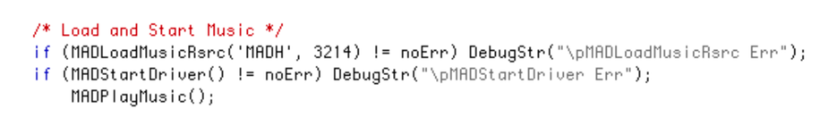

The MADLib (PlayerPRO's DevKit) allows the MOD file itself to be stored INSIDE my resource file, making my compiled application slick and a single file. 🥳
You can see in the sample code snippet below, I'm loading the music from the MADH resource at ID 3214.

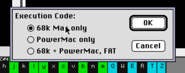

With the song selected, go to FILE and then EXPORT AS and choose APPLICATION.
This will ask what platform you want to create the application for.
I selected 68K because that's my target. You do you.

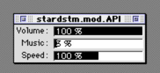

This will create a single application file on your computer.
If you double click it, the tune will play with a built in MOD player. 💃🕺

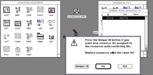

Well, Now that we have a little application of your tune, let's open ResEdit again, and load the new song application you just made into it!
Oh look!
a MADH resource type!
Open it up, select the data and EDIT / COPY it.
Now, OPEN YOUR OWN application's resource file in ResEdit.
Navigate to your MADH resource (or create a new resource and manually give it MADH as the type), and PASTE.
If the example tune is already there, you'll get a warning asking if you want to overwrite it with the new data, change the ID, etc..
Let's overwrite it (choose NO).
Save your resource file, and VOILA!
Your new awesome MOD data is inside your resource file, and, if you're using the example, it probably already had the correct ID of 3214.
