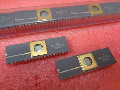

Yes, it would be very cool! An Arduino wouldn't be correct gear, but I don't know any period light-show MIDI interfaces and this would work. You could take an Arduino version and then port it to a mid-80s SBC or buy or build one from eBay to do the same thing. e.g:
This is based on a 6805 with 4kB of EPROM. It's easily fast enough for MIDI and 4kB would be enough program space; 118b of RAM enough data space. It's got 3x 8-bit ports you could use for lights, and if you needed more than 24 independent lights you could add 3:8 decoders and latches to extend it.
You could hook up a 6850 ACIA fairly easily. This would give you a 2 chip, period-correct solution. You'll be able to find something at least as good in the US.
