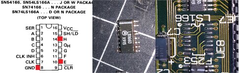

UE8 LS166 pins, missing or damaged.
With the GND gone, there was nothing happening there.
I looked all through the SE/30 schematics, and could not find UE8 listed, in order to determine where pin 8, 10, and 14 were supposed to connect to.

Looks like the bodges won't be difficult to get connected again. The red line is GND, and can be patched in to the via above it, tested and proven. The green bodge doesn't have far to go either.
Its on page 5 of the schematics - the page is titled "Video Interface". UE8 is kinda hard to find because its the only chip whose label is to the right of the pinout versus the top. Its the chip labeled "Shift Register" on the far right of the page, halfway down - its section "B5" of the page.
