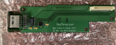

This might be of interest for those who want to stick a thrird-party serial port into a rev. A or B iMac
GeeThree Steath Serial Port For iMac 233-333, New Old Stock, Extremely Rare​
BIN $69 OBO
Located in: Hemet, California, United States

@CircuitBored may be interested to make the full set :)
