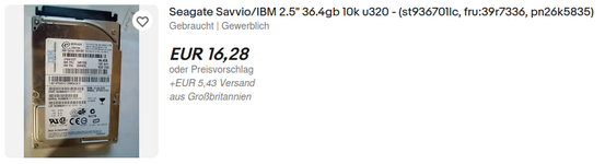

These are great, 5ms random seek time and almost no noise at all. To put them into anything with a 50 pin SCSI cable, you need an SCA 80 pin to 50 pin adapter.
The search i use at Ebay: IBM 2.5 10k U320 -sas
There is one in the UK for an acceptable price:
The adapter search: sca scsi adapter
I got two disks and i'll look out for a few more. :)
