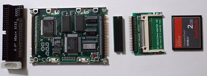

Speaking of which, below is my connector stack to adapt a full-size desktop SCSI machine to a compact flash. Left to right: aberco (eBay) "2.5" to 3.5" SCSI 50 pin laptop hard disk drive adapter Apple PowerBook", ADTX SCSI IDE adapter, ADTX connector, SinLoon "CF to IDE Adapter CF Memory Card to 2.5-inch 44Pin Male IDE Laptop SSD HDD Adapter Card (CF/IDE M)" https://amzn.to/495vLiU, SanDisk Ultra CompactFlash 2GB 15MB/s.

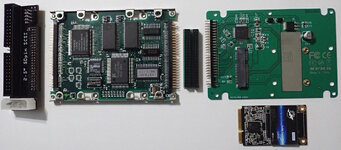

And here is my connector stack to adapt a full-size desktop SCSI machine to an mSata. Same as above except the two items on the far right: Chenyang "mSATA Mini PCI-E SATA SSD to 2.5 inch IDE 44pin Hard Disk Case Enclosure Box White for Notebook Laptop" https://amzn.to/47kHgS7, and DogFish "SSD SATA mSATA 128GB Dogfish Internal Solid State Drive High Performance Hard Drive for Desktop Laptop SATAIII 6Gb/s 128GB" https://amzn.to/46FC4bb
I tried some other CompactFlash adapters and other mSata adapters but they did not work. The ADTX is very fussy.
Additionally, I tried numerous other CompactFlash media without success. All the cards below work in a PC (the IBM microDrive may be dead), and those marked 'IDE' also worked in a Macintosh with a Sonnet Macintosh PCI IDE card.
To be clear. I could not get any of these CompactFlash cards working with the ADTX adapter.

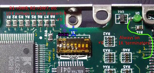

There are eight dip switches on the ADTX adapter. Perhaps I did not have them set correctly for maximum performance? My initial reverse engineering shows that the dip switches connect to ground on one side and are pulled up through 10K resistors on the other side. All the switches connect to the LSI KL5C80A16CF microcontroller. Okay, so these are software settings.
The leftmost three switches (1, 2, 3) also connect to the external SCSI ID output pins. The only other connected external pin outputs to an external SCSI activity LED.
There are other versions of the ADTX adapter board. Apparently switches 4 & 5 affect termination on those boards. However, on my version, termination is fixed with 1K resistors. That's weird. The termination resistors should be stronger. I suspect this board was intentionally designed for slower performance in exchange for lower power usage, which would be important on a laptop computer.
On my board, switches 4 & 5 change the expressed number of blocks on the media, at least as far as Hard Disk Toolkit sees them:
4 OFF 4 ON
5 OFF 1055376 1583568
5 ON 2116800 16514064
Playing with these switches and the unknown switches (6, 7, 8) did not seem to affect compatability or performance.
