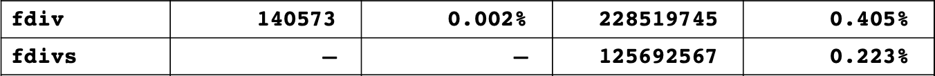

@Snial I realized this one has actually a table listing the distribution of instructions in the spec92 benchmark! And for fdivs, not a single one is used for the specint92, so the fact that fdivs stalls the integer unit for 18 cycles was never something that would have showed up by their methodology.
I did manage to check it. My initial thought was that fdiv would only be used on SpecFP 92. From page 192:
fdiv is used in SpecInt92 a bit, but as you say, fdivs isn't. Though both are used a decent amount in SpecFp. I guess your point is that Spec92 didn't test the interaction between integer operations and fdiv, so they assumed it would never happen?
