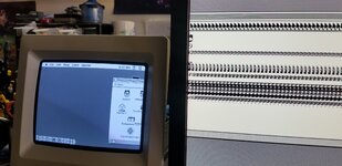

I purchased a Micron Xceed SE/306-48 card a while back for my SE/30 and I have not been able to get it to work.
Set up:
Results:
Steps taken thus far:
The next step is to recap the motherboard.
Any other suggestions would be greatly appreciated.
Set up:
- Micron Xceed SE/306-48
- System 6.0.8
- Micron Xceed control panel 2.0.1 downloaded from Gamba's Site
- DB15-HD15 adapter: MAC/IBM Video Adapter 15DM/HF-10p
- 2 different monitors with VGA input: Dell U2412Mb, ViewSonic VE155b
Results:
- I can see the external monitor in the monitors control panel (see attached screenshot)
- I can select the external monitor and change it's settings for bit depth, gamma, etc (see attached screenshot)
- I can change the location of the external monitor relative to the internal display
- I get no picture using either monitor
- When I move the cursor over to the other monitor, it disappears off of the main monitor, but then I cannot get it back until I restart
- I washed the original motherboard in the SE/30 which has not been recapped. Before and after washing the board produces no sound. Most likely bad caps. No change after washing.
- I washed the Micron Xceed board with no change.
- The DB15 display connector on the Xceed back panel looked a bit corroded, so I replaced it. No change.
- I bought another SE/30 on ebay and washed the motherboard. This motherboard had sound after washing. No change.
- I tried all of the suggested settings on the dip switches on the video adapter
- I tried setting the resolution to just 640x480 and 640x480 (vga)
- I tried color and black and white
