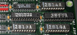

Aaand... the card is fixed.
I burned the JEDECs I recently compiled to a set of GALs, and swapped them all in. At first, it was not looking hopeful, but after fiddling around with different combinations of the old and new chips I got a working output.
The working combination is shown in the below photo. In the end it seems it was just these three chips below that were bad (you can see the replacement chips with my stickers on). According to Bolle I may have damaged U42 whilst trying to glitch it in order to dump its contents - but U33 and U34 I think were the original villains.
