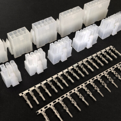

I've made a couple of little extensions like this for myself. I took the approach of extending the harness to the logic board rather than the connection to the card. This is a decent set for connectors and and pins you need: https://www.amazon.com/gp/product/B078H8F2YQ
Note, the cheap crimpers (this type) don't do these well without a bit of finangling and don't even think about trying to do it with pliers. I did manage it with the cheap crimpers in the end but it was fiddly and took a *lot* of time to get a decent result.
Alternatively, as @Nixontheknight said you can take an ATX extension and hack off half of it to use as an extension, but beware that your +5v voltage does not drop too low. You may need to adjust your PSU if using an original.
The crimpers that work best are ratcheting crimpers. Not willing to spend $400+ on a Molex brand ratcheting crimper, I bought an inexpensive ratcheting crimper (This one). It took some practice to get decent results, and I still get some failed crimps, but overall I'm satisfied with it. I just buy double the number of terminals I need (they're cheap) to account for the inevitable failures. I could not get satisfactory results with a non-ratcheting crimper - even the Molex branded one.
I’ve had this same problem and made my own extension with a pair of affordable crimpers.
