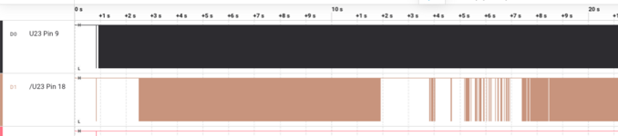

May be worth validating that both crystals on the card are still working:
Your logic analyzer won't be fast enough to capture these properly, but you should get a square wave of some sort just with an incorrect frequency. Probably pin 9 and pin 18 of U23 would be best ones to check
Would it be better to use a multimeter to check the frequency? Mine does have a mode for this.
Usually multimeter frequency measurement is meant for KHz range at most, it likely won't work. A scope would be the ideal tool to look at it, but the LA should be enough to confirm that something is there rather than nothing at all.
My multimeter does correctly display the 30.24Mhz signal on pin 9. Pin 18 which I guess should be 27MHz shows 0.00Hz.
So, a bad oscillator at Y1 maybe?
Both oscillators' outputs produce a nice looking square wave, so if pin 18 definitely should be putting out 27.00MHz then U23 must be bad.

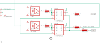

That's definitely an interesting result. If you want to do a quick and dirty test, bridge pin 2 to pin 4 on U23 and see if anything changes. U23 is simply a buffer, so this should do nothing as the output should agree with the input signal, less a smidge of propagation delay. But if the output driver is not behaving correctly, this might cause it to do something different (ie. boot further).
No, pins 9 and 18 are mutually-exclusive tri-state outputs. One of them will always be high-z if the other is driving, and vice versa. Either manipulate the FREQADJ signal or probe at pins 2 and 11 for the inputs. If 9 is showing a clock then 3, 5, and 7 should all show the same clock. If 18 is showing a clock then 12, 14, and 16 should all show the same clock. Also note that 3 and 12, 5 and 14, and 7 and 16 are wired together, so you should see the same active clock on both sides.
Right, ok. So my captures above look alright to you? This may be a false lead then.
I think the contact with pin 11 sometimes unfreezing the machine and allowing it to boot is a clue, however.
Whups. Good catch: I didn't actually look at the logic there, just where a clock could be expected.
And yes, I'd concur that touching it (ie. adding a bit of capacitance/resistance/possibly a weak pull up or down) causing different behavior is very interesting and worth digging into.

I actually socketed the 74F241N chip yesterday. Just to see what would happen, I booted up without the chip installed and the symptoms are the same. Interestingly, the contact with pin 11 of the socket still seems to unfreeze the machine sometimes. That pin goes back to the output of one of the crystal oscillators through an inductor and is not connected to anything else. Curious.
