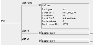

First boot attempt was a no-go, got a chime but then no picture and no boot. Examined the chip and noticed a solder bridge between an address line AD24 and an adjacent VSS (hope this didn't damage anything). I cleaned this up and then the Mac booted just fine. This is what ASP shows:
It's detected, and shows the same info that it did when it was on the original PCI card. So this is a big success. It's interesting to see 'Slot PERCH' in the list of PCI devices, I don't think that's ever generally been seen before. There is no USB bus shown at the top of the window, but maybe I'd have to populate more of the supporting circuitry to get that to show?
