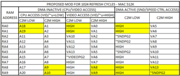

The differences are highlighted. Yellow highlight represents a known difference, and green represents an unknown. The Mac Plus table has gray text for RA9 to indicate that it isn't something the Mac 512K can be compared against.
The tables were expanded to include an additional logic input: DMA. The OE pins on the '253s are wired so they are only active when DMA is not occurring, which is anytime sound or floppy drive speed control is not accessing memory. One caveat is the '253 U13G which has its OE pin tied low, so it is always active. More on that later! The '257s OE pins are connected to active when DMA is occurring. They are the other source which creates the RA# lines, except they don't create anything for RA8 which is fully controlled by U13G.
On the Mac Plus, RA8 is created by a '253 and also as an output from BMU2. I don't know exactly what the logic in BMU2 does for RA8, but I took a guess which happened to work out.
For RA0, lifting pin 2 on U2F and tying it high, which follows the thought that swapping VA8 for HIGH when DMA is inactive means that we must also swap VA13 for HIGH when DMA is active, is correct. I suspected the missing part was that we must reintroduce VA13 for RA8 when DMA is active, specifically when C2M is high.

Here's the resulting table for this logic, highlights indicate a change from the stock Mac 512K:
What you did is awesome! You figured out the missing part to reproduce the entire address multiplexing as in the Mac Plus! I think what you did with that additional 74253 is what is programmed in BMU2.

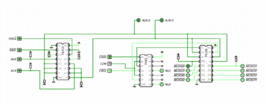

I have implemented the MacSnap subcircuit for CAS Generation (version "524," without the 74259 implemented). So far, I've been trying to make it work with just the system memory, without success.
I couldn't find any misplaced or faulty connections, and I've checked all signals I traced from the MacSnap Board pictures multiple times. Everything seems correct. Any thoughts?
There is no difference whether the 150-ohm resistors are present or not. By the way, they are pull-up resistors! (I made a mistake in a previous post.)
On the MacSnap, MCAS2F & MCAS3F are used to control the system memory. The first 512 KB of expansion RAM are managed by MCAS0F & MCAS1F signals.
I haven't tried using the expansion memory yet. I assume the subcircuit should work with just the system memory. Am I missing something? Also, please note that the MacSnap board connects MCAS2F/MCAS3F signals to CAS0F/CAS1F (system CAS lines).
Here are the things I've done so far and the results:
Tried to boot with MCAS0F, MCAS1F: No sound. Same behavior as when CAS lines are open.
Tried to boot with MCAS2F, MCAS3F: No sound. Same behavior as when CAS lines are open.
The Mac boots normally taking as CAS signals the pins #15 and #1 from the 74LS139.
This is incorrect. I've simulated the MacSnap subcircuit and found that the system CAS signals are in sync with MCAS0F and MCAS1F signals. My apologies.
According to the simulation, it should work. There must be something wrong with my build.
