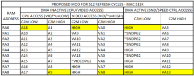

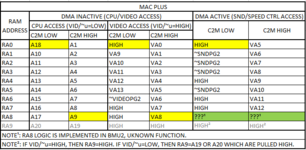

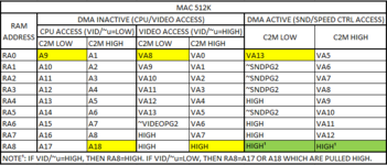

I went ahead and redrew the truth tables for the RAM addresses for the Mac 512K along with one for the Mac Plus based on the schematics to easily see the differences you explained in an easy to see format.
Then here they are again with the differences highlighted. You can pretty much ignore RA9 in this instance since that is entirely unique to the Mac Plus (for now!).
The relevant difference is that VA8 and HIGH from RA0 and RA8 are swapped, so when C2M is high, there are nine bits of VAx lines going to RA0-RA8 which creates 512 cycles for refresh. A9 and A18 had to follow suit for consistency, otherwise when the CPU writes to memory for video data, it would be all messed up.
If we wanted the Mac 512K to natively create 512 cycles for memory refresh, we could cut a trace or two (or socket the ICs and bend legs out) and solder a couple bodge wires to make it more like the Mac Plus in that regard. Not elegant by any means, but it should work!
Going beyond that, we could also hack it up further to create 1024 cycles of refresh which is required for the particular DRAM ICs I've got on the breadboard. Just move VA9 from RA1 to RA9 and replace where VA9 was at RA1 with a pull up resistor. A10 and A19 would need swapped at RA9 and RA1 to follow suit. This is what its truth table would look like:
If this actually works, then for a cleaner mod: the IC responsible for RA0 & RA1 (U4F on the Mac 512K) and RA8 (U13G) could be removed, sockets installed, then the memory expansion board use pin headers to connect to the sockets. All of the signal swapping could be done on the expansion board, so no cutting logic board traces required! Also, the unused half of U13G could then be connected like the Mac Plus to create RA9, except with the additional changes above for 1024 refresh cycles.

I think the modifications to change the refresh cycles should be straight forward as outlined above. As far as I know, the reason the 512K Mac accesses RAM in 512KB chunks is due to only being wired for 256 refresh cycles, which was a relic of the 128K Mac but still compatible with the DRAM ICs used in the 512K Mac. Changing to 512 or 1024 refresh cycles will allow the use of additional RAM address lines, which in turn means larger chunks of RAM access at one time. This thread has a few examples of multiplexing the logic board's CAS lines with upper system address lines to select more chunks, including the design you reverse engineered from the MacSnap board!
For fun, I've ordered some 512-cycle 9-bit DRAM ICs to test this theory in practice.

Thank you very much for highlighting the differences between the Mac 512K and Mac Plus truth tables for RAM address generation. I completely overlooked the difference in RAF0 generation. Now, looking at the bigger picture, everything fits together and makes perfect sense!
By comparing the two truth tables side-by-side, we can also clearly see how hardware address decoding determines the screen memory location, and how it differs between the 128/512K Macs and the Mac Plus. Unlike the stock 512K Mac ROMs, the Mac Plus ROMs figure out how much memory is actually installed and then set ScreenBase (a pointer reference to a specific location below the top of memory for the screen buffer) appropriately.
I noticed the Mac Plus schematic shows RAF9 as NC (Not Connected) at the SIMM sockets. Must be an error since each SIMM needs ten address pins and eight data pins, otherwise 1MB SIMMs wouldn't work.

I finally figured out and fixed the sound issue with the 512 cycle refresh mod! As suspected, VA8 and HIGH being swapped between RA0 and RA8 results in some sound data being stored (initiated by the CPU) into a new location in memory, while the sound hardware for accessing memory is still expecting data at the old location. To visualize exactly how the sound hardware accesses memory, I added to the tables I previously made.
The differences are highlighted. Yellow highlight represents a known difference, and green represents an unknown. The Mac Plus table has gray text for RA9 to indicate that it isn't something the Mac 512K can be compared against.
The tables were expanded to include an additional logic input: DMA. The OE pins on the '253s are wired so they are only active when DMA is not occurring, which is anytime sound or floppy drive speed control is not accessing memory. One caveat is the '253 U13G which has its OE pin tied low, so it is always active. More on that later! The '257s OE pins are connected to active when DMA is occurring. They are the other source which creates the RA# lines, except they don't create anything for RA8 which is fully controlled by U13G.
On the Mac Plus, RA8 is created by a '253 and also as an output from BMU2. I don't know exactly what the logic in BMU2 does for RA8, but I took a guess which happened to work out.
For RA0, lifting pin 2 on U2F and tying it high, which follows the thought that swapping VA8 for HIGH when DMA is inactive means that we must also swap VA13 for HIGH when DMA is active, is correct. I suspected the missing part was that we must reintroduce VA13 for RA8 when DMA is active, specifically when C2M is high.
I achieved this by implementing another multiplexor. I used a '253 because it's what I have, but it could have been a '257 like the rest of the sound hardware memory access circuit. I only used half of the IC, so one OE pin was tied high to disable it. The half that I used I connected similar to the Mac's '257s for the sound hardware as follows:
Pin 1 (OEa): ~DMA - only active when sound hardware is accessing memory
Pin 2 (S1): tied LOW - never select A3 or A2
Pin 3 (A3): tied LOW - not used
Pin 4 (A2): tied LOW - not used
Pin 5 (A1): VA13 - selected when C2M is high
Pin 6 (A0): tied HIGH - selected when C2M is low
Pin 6 (ZA): RA8
Other input pins except power: tied low
Other output pin: floating
The remaining issue is that U13G is always in control of RA8, and we must make room for the new multiplexor to take control when sound hardware needs to access memory. I did that the same way the rest of the system's '253s do: by taking the OE pin for the implemented half o the IC (pin 1) and connecting it to the DMA signal.
Here's the resulting table for this logic, highlights indicate a change from the stock Mac 512K:
