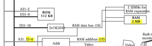

Comparing the block diagram in the Classic II, LC II, and Color Classic developer notes:
Classic II shows 2MB onboard RAM, and 12 bit RAM address bus (not completely accurate -- only 11 lines to the SIMM slots), and 25 (A31 + A23 to A0) CPU address lines to the V8/Spice/Eagle.
Same for the LC II, except for 4 MB onboard RAM.
However, on the Color Classic, Apple claims four additional CPU address lines going to Spice, meaning now 29 address lines (A31, A27-A0)! (Apple is also more accurate in describing the RAM address lines as being only 11).
Bomarc only shows the standard 25 CPU address lines going to Spice, not 29. Bomarc shows 11 RAM lines going to the SIMM slots. That limits SIMM memory to 8 MB, unless Spice includes a sneaky unconnected pin.
Hi David, thanks for reading my huge wall of text! Yeah, I also noticed that in the CC dev note, and assumed it was a mistake since the Bomarc schematic only shows A0-23 and 31 going into Spice. I think it's because the A24-27 do indeed go to the PDS slot, and they mistakenly put them as going to Spice as well. I'm pretty sure the dev note is wrong about that.

The Color Classic does not have extra address lines going to Spice. Here, have the real Apple schematics. :cool:
