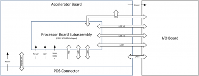

Serious proposal: accelerator and peripheral expansion system

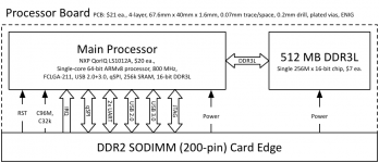

Technology and prices have changed in the past year. I posted pictures of a board with an STM32H7 processor running at 400 MHz and costing over $20. Now an iMXRT1050 at 600 MHz can be had for just $5.60. The iMXRT1050 also integrates two USB PHYs, further reducing cost over the old design. So I am going for this processor now.
