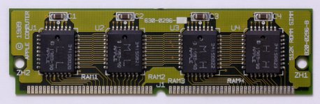

Very nice close-up pics! I actually designed my board pretty much the same way trag said. I probably would have started from a schematic except the app I'm using is only for board layout. But for this particular board, the schematic would be kind of pointless anyway. It's basically "hook all the corresponding lines on each chip together except for the data lines", and then find a place somewhere to connect each SIMM pad to its corresponding net. I found the 64-pin SIMM part in EAGLE, and copied it into FreePCB manually by looking at the coordinates of all the vertices.

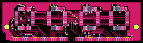

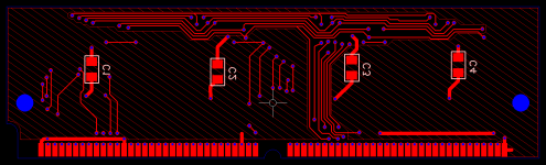

Here's what I have now after cleaning up the ground copper fill on the bottom layer, adding a VCC copper fill to the top layer, moving the capacitors to the bottom close to the PLCC chips, and a few other minor fixes:
Not sure if I'm happy with the placement of some of the vias near the PLCC pads. It's hard to find room! I was designing these vias with the minimum acceptable size for BatchPCB so that's why they might be kind of big. I can't fit them when they're that big. Maybe with Seeed Studio I can go smaller.

I just realized I'm an idiot and I should have used Eagle to make this board. For some reason I thought my board was wider than 4 inches (it's not) so Eagle's free version wouldn't work (it will). Maybe I thought I'd need 4 layers too. Whatever...I'm going to stick with FreePCB because I'm pretty familiar with it now but Eagle really would have been a smarter choice in hindsight.

Well, I'm almost done routing the through hole PLCC socket SIMM. It's a bit taller now (about 1.5 inches). Any clearance problems in the SE/30 for instance?
Also there isn't a lot of room for much ground fill type stuff, especially near the sockets because I have so many traces going through them. Will that pose any problems?

Your surface mount board looks great. Is it the completed design? Looks like moving the caps to the back opened up the design a little bit. As far as assembling I would try a paste stencil and a hot air gun or hot air solder rework station.

Thanks! I think it is the completed design until I start making it USB programmable. Yeah, it definitely opened up space by putting the caps on the back. I'm designing a through hole version now. I'm thinking I might just order some surface mount boards now and then finish the through hole version after that. It's a learning experience for me! I like the solder paste/hot air idea too. I think I saw a YouTube video where someone put together a board with that combination and it looked really easy!
