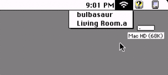

Using the proven software development technique of "trying random sh*t until something works", I now have a functioning network list, reading from the VM300:
Still lots of problems to solve, the main one being that the whole system locks up for 10 seconds when clicking the menu (while waiting for the VM300 to provide a response).
I'm gonna take a break on this for a little while.

OK I've implemented the Thread Manager into the networking stack, which now allows the HTTP requests to frequently yield time to other tasks. But there were still limitations to the Thread Manager, so I had to move all of the long processing into a background application. Long story short, the net result is that the menu is now smooth as butter.
Next task is to try and get switching between wifi networks working, and add a heap of error handling...
