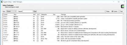

Compiling Retro68 can take hours, so ensure you've installed all of the dependencies in Cygwin. To help, I've attached a screenshot of all the packages I have installed - there's nothing more frustrating that sitting through 2 hours of compilation for it to crash out and you have to start over again. Also ensure you've got at least 9GB free on your drive - it's huge.
