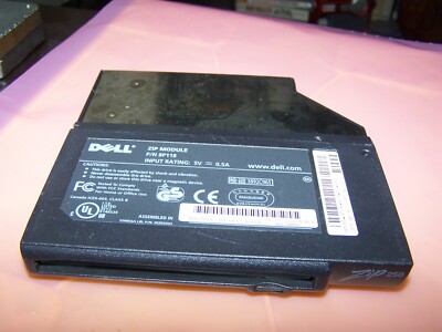

I don't understand. Dell Zip250 drive modules work in the PowerBook G3?
Like these?

@ried yes, I think that Trash80toHP_Mini meant just that.
The drive, the main part, should be identical to that of the "VST". Only the small internal card interface that connects the drive to the PowerBook G3 "expansion bay" connector changes.
Here in Europe they are not very widespread... For me now the problem remains unsolved. But it was a really nice tip!
mg.man
FWIW, I recently 'restored' a faulty VST PB drive by doing just that - picking up a cheap Dell laptop expansion bay drive and removing the drive mechanism, then swapping that into the VST housing. Been working fine ever since.
Your issue might be more serious, could be the little controller 'board that goes from the Zip mechanism to the PB expansion bay connector. The Dell drive was pretty cheap ($10 - $15 IIRC), so it might be worth a try?

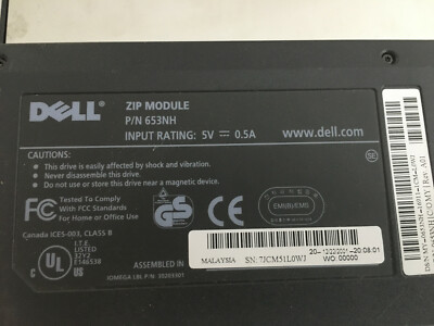

Well, I can confirm that this model of Dell expansion bay Zip 100 drives requires a lot more than a housing swap.
Disassembled both. The removable green connector board on the back of the G3 unit does not fit the Dell drive. They are similar, but different connectors. Still investigating.
mg.man
Umm... that's a Zip 250 Dell drive. I've successfully swapped for a Dell Zip 100, no experience with anything else.
