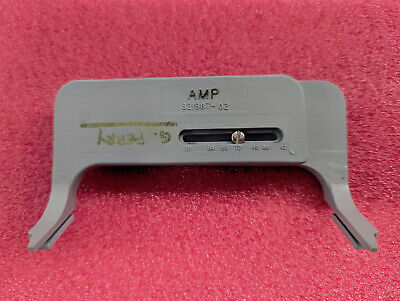

Thanks to an eBay link from @RepairManiac, I was able to purchase one of the SIMM removal tools.
Here are some close-up pictures.
It is made out of a really high-quality plastic. The grip feels heavy, though. Weighted with a metal insert?
The adjustment slide with the single screw lacks notches, so it isn't very accurate when choosing the memory width of 30, 72, etc. At first, I thought that was to allow you to adjust the width based on the PCB. But, really it should be fixed to the width of the latches on the memory slot, which should be fairly precise. No big deal.
The first step of guiding it onto the top of the memory stick is a little awkward. But after that it slides down and releases the latches like butter! No 'clicking' and no pressure. It is surprisingly amazing.
Maybe I'm being too optimistic, but it seems like this would make broken plastic latches a thing of the past.

RepairManiac
Active member
@David Cook That's awesome and it was NEW too where mine is heavily used. It does feel heavy - weighs 2.5 oz.
I just used it again, for the first time in decades, on a Mac SE/30 and YES it does work like butter once an adjustment was made! Also used it to remove the ROM SIMM too.
It was Apple's answer to technicians complaining of breaking those fragile clips on early Macs. Doesn't look like it was a required tool, but we had one on every Mac bench. Sadly I can only find the one now.
If anyone else is interested, someone *not me* just listed another one on eBay - Search for Amp 821987-02
