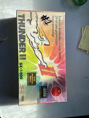

David Cook
It’ll go for more than I want to pay, but a 1600 is up for sale if anyone wants one (bonus points for ripping the ROM).
There were two of these from the seller. I bought the first one (labeled #2 ironically) for $350. The seller messaged me today and said "Bro! Don't open that box. Resell it immediately for $810!" (not his actual words). I thought that was pretty cool of the seller.
Here is the unboxing. I could hear the depreciation as I broke the seal.
The ROM is not socketed. What would you like me to use to rip the ROM? It's version 3.0.3.
zigzagjoe
Use the slot rom utility: https://www.gryphel.com/c/minivmac/extras/slotrom/
It'll save files next to where it runs. As the transformations needed (address/data bit swaps and inversions, if any) should hopefully be known from the lesser cards, there shouldn't be a need to desolder it from the card.
