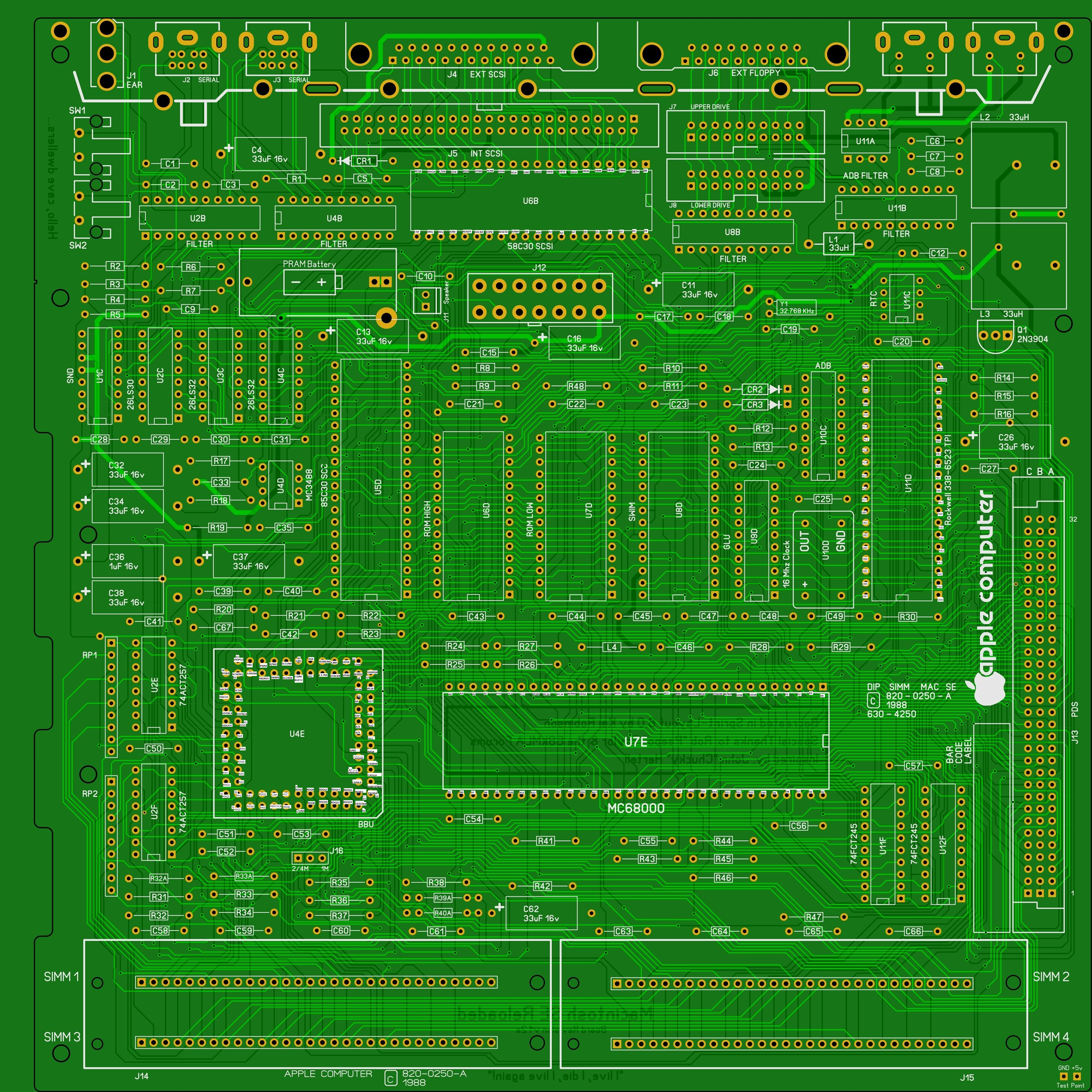

I know this is about reproducing the board itself, but I thought it might be useful to have a schematic version of the SE board. Well... I didn't get that far, but I did label many IC pins in Kai's (latest?) board image:
This really helped me understand how the 68k, TPI, GLU, and BBU are all connected together.
My eventual plan is to create a "Mac SE" board using more commonly available components. For instance, the TPI could be recreated with two VIAs. And the RAM SIMMs could be replaced with a bunch of socketed RAM DIP chips (like the Commodore 64 used). Just a weird hack idea, pretty pointless. (since I'd still need the BBU and GLU from a real Mac SE)

What is the TPI, I explained, was an error - it really is just a 6522 VIA - the pinouts didn't make sense if it was a 6523 TPI. Also it would be uncharacteristic for apple to suddenly use that once, then go back to the 6522 for everything else.
Read back a few pages - we've all but reverse engineered the Glu, @quortenis working on the BBU and I've just begun manufacturing SIMMs...

How much info would you need? Happy to furnish you with a full PCB layout in Sprint - so you can see what connects to what - same goes for anyone else at this point - i'm starting to hit a wall, need more beta testers with complete boards :D

Schematics would be helpful. I have a 16550a logic analyzer I could hook up to the BBU if I could find a good way to do it. Perhaps making an interposer board with some mictor connectors that I could interface too. I used to do a lot of capture when debugging my graphics FPGA on the PCI bus. it might be a bit of a slog, but maybe I could reverse engineer it this way. I have a MAC SE/30 already. Hopefully my old logic analyzer still works :)

Then you'll be wanting one of these! I designed a universal Through-Hole PLCC84 breakout - remove the original PLCC socket from the board, solder this board in place with standoff pins, then solder new socket to this board and voila - all pins accessible easily with a Logic Analyzer. Attached Gerbers if you want to get a set made. For the Mac SE, the schematics aren't really available, there's only a single page available and it's grainy as hell. I'll post the Sprint Layout in a minute - you can download a trial version that should allow you to use it for 30 days, but i recommend buying it - it's excellent software for the $49 it costs.
