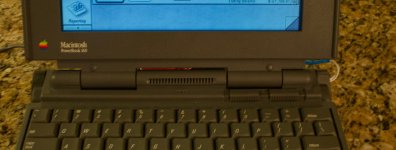

Well there isnt anything left of the posts, they have all crumbled away leaving only the jagged remains on the base.
Anyway, Where to get solvents? only thing around here is lowes and home depot is here too but its a haul.
techknight
I guess I have to experiment with acetone and old pieces from leftover powerbook parts. Problem is, I have to leave the brass fittings and etc in place because theres nothing left, its all crumbled and busted away, so ill have to melt the plastic as a slop in acetone, and brush it in place.
Problem is, What brush? arnt brushes plastic too?
techknight
I am most likely going to do it this way:
http://www.1000rr.net/forums/lounge/56168-do-yourself-abs-repairs-cheap-solution-fixing-fairings-2.html
Only problem is, I know using acetone or other solvents for welding is a problem because it creates air bubbles in the plastic as it hardens and drys. Problem with that, its in the hinge area so that can weaken it enough to re-break you think?
Also what brushes or spout style bottles would be ok with acetone sludge? Almost need 3D printers to extrude new posts. And just use ABS glue to insert the post onto the original plasic, and use a bit of acetone to soften the replacement post to insert the brass ring. That would be ideal.
mcdermd
The only way I've done this before was to take what I could of the old bits of the threaded socket and lightly superglue them in place. I then scored the area around it with an xacto knife. I made a rectangular form as large as would fit inside the empty space around the standoff before filling it with JB Weld. After fully curing, I filed and fitted the JB block to fit snug with the hinge.
I had to rebuild the bezel side also as the cylindrical area had cracked out. With that side, I completely filled it, then used a drill press to recreate the hole. It has been nice and solid since but admittedly, I've also been rather ginger with it too.

Here is a success story with pictures as of 2018. https://imgur.com/gallery/xlJQgIW#VDMwwrW
Further caution/heads up for beginners out there. When you remove the 2 screws under the the caps and take the front bezel off, the two screws you just removed ARE 50% of the hinge anchor. Do not open or close the lid/move the hinges (unless there is remarkably little resistance) once you have removed the bezel as the remaining 2 anchor points will snap (shatter maybe a more appropriate term) very easily.

Here is my progressive repair of one of the two broken hinges on a PB 160. This is JB weld. It is a game of less than millimeters to get these to line up. It was difficult even using the remains of the shattered support. The pictures are from the first attempt. I did heap up the JB Weld, but it flattened some during the initial drying. I used a dremmel to shave away the JB weld so the hinge would fit. It was not a quick process...shave, try hinge, find resistance, shave, repeat. In the pictures with the hinge screwed on, you can see that the right post is a little off...I got a screw in, but it broke fairly promptly.
On the second try (not pictured). I coated the screw and the back of the hinge with olive oil, then, carefully keeping the oil off the post, I screwed the post onto the hinge, then put the JB weld down and pressed the hinge into place and screwed on the good side to hold it in place for drying. I was very careful with replacing the LCD, etc but so far so good. Also,the unbroken posts were shored up with some JB weld while there , but even in doing this, I had to dremmel a lot away of that JB Weld that had just been put down to get the hinge back on.

Impressive job on the hinges! I have many laptops with damaged hinges, but I've never tried a proper repair. Once there was a conspicuously lacking metal bracket - there never was one there but there clearly was space for one - so I cut one out of sheet metal, and it served to spread the tension across the lid instead of focusing it on right where the hinge was. Horribly bad design thats guaranteed to fail when the plastics age a few years.
The other time I didn't feel like messing with JB weld (I've never used it) so I used a Dremel to modify the hinge so that it was looser and put less tension on the plastics. Don't worry, it wasn't a vintage laptop, just a poorly designed Lenovo from the '10s, but yeah it made it rather floppy then.

One thing i did with a powerbook 170 and a IBM thinkpad with stiff hinges is take the spring out of one of the hinges and loosen the hinges using a plyers now only one side has a spring in the hinge holding the screen and other side is free. Just dont loosen the spring hinge to much.

Hi, I was successful today with a PowerBook 170.
I have three of them, all with one or two broken hinge mounts.
Today I used the cover of a dead PB 145B, equipped it with the PB 170 hinges. I put little MoS2 Oil on the hinges and cleaned them. The active matrix display of PB 170 fits and now - I hope - it will live a bit longer.
