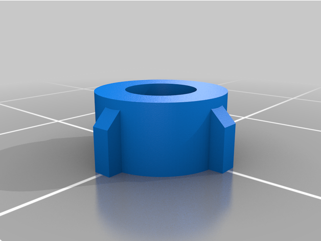

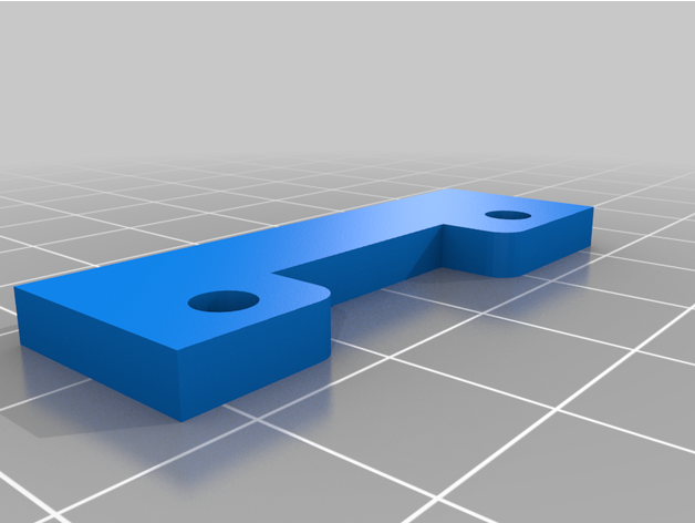

I had a similar situation last week with a PB170. There's really no easy way to do it other than to gently pull the screen bezel at the same time you try to undo the screw. That will place some pressure on screw and enable to turn it a bit. It will take a little time and patience. The plastic holding the standoff will break off anyway, so it's not a horrible situation. It is repairable. Thingaverse had 3D files of the standoffs and the hinge supports. They can be found on eBay as well if you don't have a 3D printer.
hinge support
standoff
