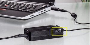

MacUp72
I bought an 15-24V adjustable Hama universal adapter like this:
but I think this one is very similar:
I considered buying the newer versions but these are controlling the voltage internally, I prefer to set it manually by switch .
