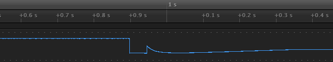

I spent a long time with the IIsi logic board and a scope, but I couldn't figure out exactly what's wrong with that board and why it turns itself off. However, I'm suspicious that the "soft power mod" doesn't work correctly with the IIsi. What I found was that the IIsi power button is wired directly to the 68HC05 microcontroller on the logic board. Pushing the button grounds an input pin. Then another 68HC05 output pin is wired directly to the /PFW pin on the PSU connector. There are probably other capacitors and components in parallel with these, but I'm certain of these two connections. The 68HC05 is powered from 5V standby power, so it's always on.
When the power key or power button is pushed, I observed that /PFW goes high for about 700ms. And when a shutdown is requested through software or the power button is pushed a 2nd time, I observed that /PFW goes low for about 50ms. That all seems good. But when the IIsi is steady-state on, it looks like /PFW just floats, or is somehow driven to an intermediate value around 1-2 volts. That's bad, and it screws up my soft power mod, which is basically just your single-transistor inverter from another thread:
The only difference is that I used a MOSFET instead of a BJT, so there's no resistor on the base. I tried it with and without a pulldown resistor for the base (or the gate in the case of MOSFET).
If you look at the IIci startup circuit schematic, the symptom I'm seeing could be perfectly explained if diode D6 were missing. That diode holds /PFW high once the main 5V supply is on, even after the startup pulse generated by UE13 is over. But on my IIsi there doesn't seem to be any equivalent to D6, or it's broken, or maybe it's actually located inside the IIsi power supply instead of on the logic board.
I tried adding my own external diode to serve the same purpose. It sort of worked: the IIsi would turn on from soft power, and stay on, but when I tried to turn it off, it would turn back on again after a half second. The observed voltage for /PFW also didn't make sense for what I thought I understood about the circuit. It was too low, as if the 68HC05 or something else were actively pulling it low, but only weakly. I gave up at that point, and concluded I just don't understand how this is supposed to work.
So in the end, I'm still not sure if my original problem was in the IIsi logic board, or in the IIsi power supply and further compounded by a flaw in my soft power mod with the ATX power supply.

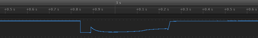

I tried replacing my soft power mod with your circuit exactly: an NPN BJT with 1K pullup and 10K base resistor. The startup from soft power works reliably, but it won't turn off. Here's what I observe on the /PFW signal from the logic board, when I try to shut down:
The /PFW signal starts at roughly 2.7V (I don't know why this strange value). Then it goes to 0V for 50 milliseconds, but I think this pulse may be too brief to fully shutdown the ATX supply. After the 50 ms pulse, the voltage jumps up to 1.3V, slowly decays to 0.1V, slowly grows to about 2.9V, then jumps back up to 2.7V.
Then I tried adding an additional 10K pulldown resistor for the input signal, and this seems to work. The shape of the /PFW waveform is the same as before, but the overall voltage levels are slightly lower due to the pulldown. This prevents the voltage from creeping back up to the point where the transistor turns back on after shutdown, so it turns off and stays off:
So I guess that's success. :)  But I still don't understand why the BJT behaves differently from the FET, or why the voltage creeps up again after shutdown, or why the voltage is a weird value like 2.7V instead of a valid logic value. But assuming this is normal behavior (?), the good news is my IIsi logic board is OK and it's the PSU that I need to address. So I can either recap it and hope that fixes everything, or replace it with a micro ATX supply inside the case, or use it with a standard ATX supply outside the case like I'm doing now.
